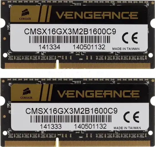

Just put together a Intel i5 NUC (NUC5i5RYK) and the Corsair Vengeance DDR3L sticks have some rather big stickers on them. Should I remove them for cooling? But I assume that might/will void warranty.
The sticker is the whole Vengeance (black) + Serial (white) thing. And given the NUC's poor tiny cooler, I was pondering whether to remove the stickers to help the RAM chill a little more?
Would that help and would it be worth voiding the warranty? Or what's an alternative good cooling system for such a NUC that I plan to occasionally use as a portable dev desktop? So Visual Studio compiling will turn the heat up a bit.

  • No; If Corsair thought the stickers were a a heat issue they wouldn't be used. Yes; If you remove the only identify mark on the product, you will void your warranty, because there will be no way to track if you are eligible for said warranty. – Ramhound Jul 30 '15 at 21:37
    I did :-) I have always removed stuff that got in the way of cooling (and always clean it up after). Then the freaking things (some vengeance) had a real hardware problem. Lifetime warrenty, except the terms of the warrenty when I read it were removing the stupid stickers voided the warrenty. Uhh yea 2 years later the saved stickers are not going back on the way the came off, and that is the end of that. – Psycogeek Jul 31 '15 at 06:30
  • @Psycogeek Yeap! You never need warranty until you void it. Murphy is always on duty. :) – CodeAngry Jul 31 '15 at 15:29
Strictly for preference, but realistically it will make almost zero difference. Your RAM is designed specifically for operating with the appropriate labeling attached.
Honestly I would be more concerned about dust attaching itself to the now unprotected adhesive that once affixed the label. I'm sure that would keep in more heat even!
