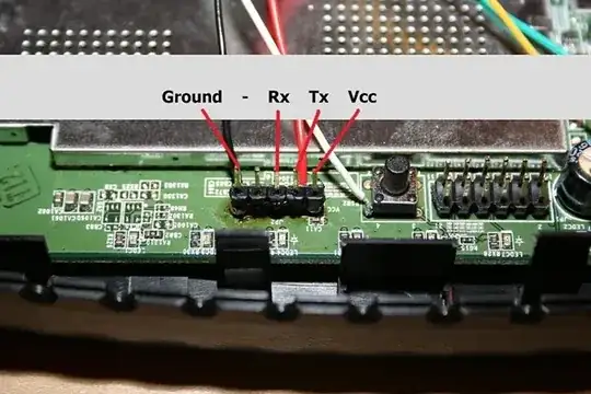

Most factories left serial port on the main circuit board to test/troubleshoot their product. Sometimes you must solder wires to the ports, Like what I did in the PIC below, check My blog if your want more info about soldering your wires. enter image description here
and sometimes they are ready to use enter image description here
Now you need something called Arduino "Micro-controller" We will use it to make a communication between your PC and your router over the serial port. Connect your Arduino to your router like this TX-------RX
RX-------TX
GND-----GND
VCC----3.3V
WARNING DON'T connect VCC to 5V
