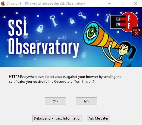

I just downloaded HTTPS Everywhere and it's running great. However, I want to enable it all going through Tor (as much as it can via the configuration dialogue). However, that option is greyed out. I have the tor browser, what would I do to get this to work?
Here's the configuration prompt:

From Tor Ticket #8222 :
"Check certificates using tor for anonymity" should really be "only check certificates using Tor for anonymity". If it's unchecked, it means the observatory will use a direct SSL connection if it cannot find Tor.
That option will be greyed out if HTTPS Everywhere failed to successfully identify a method for making requests through Tor when it started. But if Tor is installed or running or works correctly on a future browser startup, the observatory will switch to using Tor at that time, even if this option is unchecked.
This option should then be available and not greyed-out when Tor is running. If that is not the case, update to the latest Tor and Tor browser versions, and if this still arrives, then you could open a new support ticket.
However, you are safe even when the option is greyed, since the communication with the EFF is encrypted.
As far as I know, the Tor browser already contains HTTPS Everywhere and SSL Observatory, so you do not need to install the Firefox add-on. SSL Observatory is off by default though.
