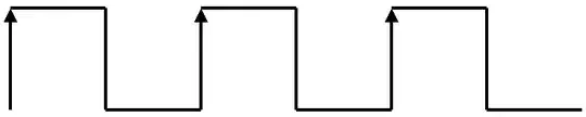

What does a cycle mean?
Clock is a signal used to sync things inside the computer. Take a look at Figure 2, where we show a typical clock signal: it is a square wave changing from “0” to “1” at a fixed rate. On this figure you can see three full clock cycles (“ticks”). The beginning of each cycle is when the clock signal goes from “0” to “1”; we marked this with an arrow. The clock signal is measured in a unit called Hertz (Hz), which is the number of clock cycles per second. A clock of 100 MHz means that in one second there is 100 million clock cycles.
In the computer, all timings are measured in terms of clock cycles.
Source Clock
