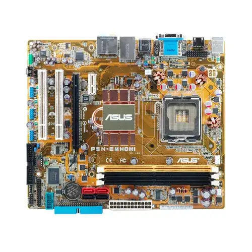

Looking at your board it appears that Slot#1 and Slot#2 (colored black?) should be used for the memory -- this ASUS board has 3 memory slots instead of the usual 4 and they are organized differently. Alternate is not right here.

If you have a motherboard with 4 slots, and you own two similar memory sticks compatible with your board, it is critical to place them on the correct two slots (usually alternate slots). The board is wired to use them in dual-channel mode correctly on these placements. Suitable slot pairs are usually colored the same to remind you about this.
So, YES, you should care. You have the right memory (DDR two matched units) and you are running single more just because of incorrect memory placement.

  • I'm pretty sure i've now swapped em into slot #1 and slot #2 and it's still saying single-channel :( – Pure.Krome Aug 20 '09 at 01:32
  • Slot #1 is yellow, #2 is black. The modules should be in slot #1 and #2. However, you are still limited to a single channel as the board only supports one channel. – David Schwartz Feb 04 '13 at 04:01
your mobo supports only single channel mode. usually support for dual channel mode DIMM is not implied but clearly stated. the link you provided mentions single channel DDR2 1066 single channel model only

To get RAM to work in dual channel mode, you have to insert it into the correct RAM slots on the motherboard. Please check the manual to see which DIMM slots should be used to use Dual Channel mode.

  • Did you put them in the correct DIMM slots? As shown in the other post, you probably have to put them both in the black slots. – Chris Thompson Jul 21 '09 at 03:53
  • I've done this and it's still running in single mode. – Pure.Krome Aug 20 '09 at 01:31

  • @Russ: You are correct that he doesn't have them in the correct slots. I didn't see that this board only has 3 slots (was sleepy on my last post), he can try them in the 2 black slots to see if it comes up as dual-channel. Typically in a 4-slot system he would have been correct to have them in slots 1 & 3. Thanks for the 'wake up' call... – JFV Jul 21 '09 at 19:24
