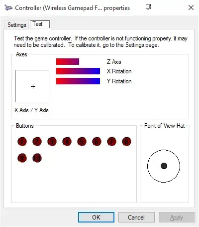

Figure 3: Game Controllers > Advanced
Figure 4: Game Controllers > Controller (Wireless Gamepad F710) > Properties
Figure 5: Game Controllers > Controller (Wireless Gamepad F710) > Properties – D-Pad Pressed Up-Left
Figure 5: Game Controllers > Controller (Wireless Gamepad F710) > Properties – D-Pad Up-Left Pressed
Figure 6: Game Controllers > Controller (Wireless Gamepad F710) > Properties – X Button Pressed
Figure 7: Game Controllers > Controller (Wireless Gamepad F710) > Properties – Left Thumbstick Held Up-Left
Figure 8: Game Controllers > Controller (Wireless Gamepad F710) > Properties – Right Thumbstick Held Down-Right
Figure 9: Game Controllers > Controller (Wireless Gamepad F710) > Properties – LT Button Pressed
