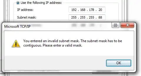

However, those RFCs seem to be outdated. On Windows 7 SP1 for example, it is not possible to set such a subnet mask:
Contiguous subnet mask required on Windows 7

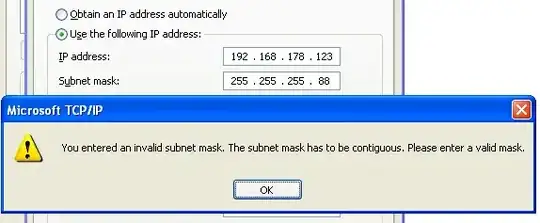

Even on Windows XP SP2, this was not possible any more:
Subnet mask Windows XP SP2
