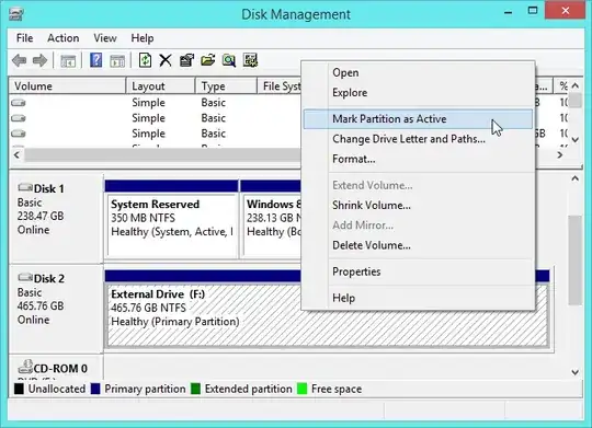

  1. Mark the partition as Active using Disk Management.
Mark Partition Active
