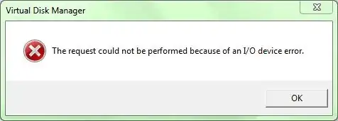

There is nothing physically wrong with the HD, no strange noises, no abnormal temperature differences during operation. What's led here has been a step by step series of losses, first of the MBR, then File Table and now possibly, the firmware is corrupted. The HDD is recognized in Disk Management, but when I try to assign a label or initialize, it returns a Device I/O Error popup:
Error message: The request could not be performed because of a I/O device error.
Last thing done in the steps of troubleshooting so far was type Clear in DiskPart, hoping the drive would be able to be re-initialized and labeled again. That's when the I/O error popup started to appear. Added to that, though visible in DM, drive is not visible in DiskPart:

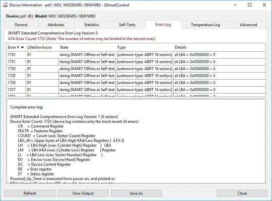

Since my drive is failing and I have these i/o errors, I post the S.M.A.R.T results of my WD20EARS with a whopping 91 hours of lifetime. External Backup Drive.
First lets see CrystalDiskMark results:
WD20EARS_CrystalDiskMark
and the results of a normal hdd:
Normal_Benchmark
Here the smart-data:
smart
and the error log:
error-log
and the self-test:
self-test
