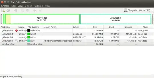

GParted Before
GParted before partition modification.
Gparted after
Gparted after modification - Overwrite sdb4, the ISO9660 OS partition and sdb5, the ext2 casper-rw partition, with a FAT32 partition for persistence files.
Persistence partition
Persistence partition - Create an uniquely name folder for each OS, (that requires persistence)
Persistence folder
Persistence folder - Add a casper-rw file and optional home-rw file to each persistence folder. A home-rw file can be made by renaming a casper-rw file. A home-rw file is like a seperate home partition on a Full install, it can be reused after version upgrades.

This may be the multiboot solution that you need.
https://www.ventoy.net/en/index.html
This bootable USB maker creates two partitions in a USB drive. One is 32MB FAT 32 EFI partition. Another one is exfat partition that is equal in size to the rest of the USB drive. You can copy any number of ISOs including Windows to either the root folder or any subfolder. You can also use this partition for normal storage.
Select this USB in the boot menu and it will show all the supported ISOs as a list to choose from. In my experience it worked for Ubuntu, Kubuntu, Mint, Clonezilla and Windows.
Ventoy
