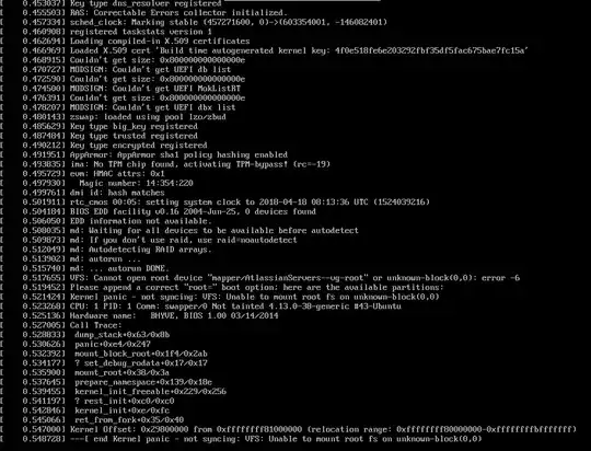

I am really struggling to figure out how to fix the boot for my Ubuntu server after running some updates recently. This is the error on boot
boot error
I can't seem to see any grub loader screen for repair, so I reattached the installation ISO to the VM, and select repair. I've tried a few options, but the result is always the same.

I have tried the advice for similar looking issue here including the mount options Kernel Panic - not syncing: VFS: Unable to mount root fs on unknown-block(0,0) but still get the same error.

  • I have even now tried to re-install Ubuntu from the original ISO (keeping the data). I can now see the grub screen, but still get the kernel panic message, no matter if I try 4.13.0-37 or 38, or any of the recovery modes – Zief Apr 20 '18 at 10:03
