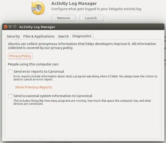

For Ubuntu 16.04 LTS, the settings are still available after install, at any time, in the Activity Log Manager.
Here are some screenshots of it in action:
The very first screen shot shows the sending of information to Canonical.
The rest affect the size of your log files.
