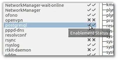

GUI Tool
One GUI Tool I particularly find interesting is systemd-manager, it is still in development stage and hasn't been made it's path to Official Ubuntu repository. However, you can install it very easily from Systemd-Manager's github page. The releases contain a .deb package, which is very easy to install. You need GTK-3.16 or higher though.
Once you download and install, you can start it with systemd-manager command. Start it.
The application has two main view. One is Systemd Units and other one is Systemd Analyze. You can switch it with the label in top-left corner. See the screenshot.
Swithch Between Views
And There are three types of units you can manage. Servcies, Sockets and Timers. You can switch between them. See the screenshot.
Switch between unit types
Displaying Information
The three main tabs are Files, Journal, Dependencies.
  • Files is the selected unit's configuration file.
  • Journal is the live systemd's output while enabling/disabling/starting/stopping units
  • Dependencies shows what other services or units must be enabled to start a selected service.
Status Indicators
There are two columns beside the name of units to indicate the Status. Left one indicates whether that unit is enabled to start at boot and the right one indicates whether that unit is currently running. See them in picture.
Enabled at boot status
Currently running status
Control Switches
To toogle enabled-at-boot or running status, there are two toogle buttons at the top-right corner. Enabled means the units will start and boot. See them in picture.
Toogle switches to enable/start
The complete view of the application is shown below
Complete View
Hope this will help. I get benefited from other answers about systemd, but really needed to gather the information in one Place.
