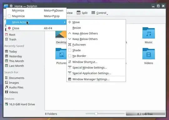

  • KDE (kubuntu-desktop^) have mnemonics, they may be accessed from Alt+F3 (so called Window Operations Menu) - for example to keep window above others you need to click Alt+F3, M (for More Actions), A (for Keep Above Others) and menu is rich:
