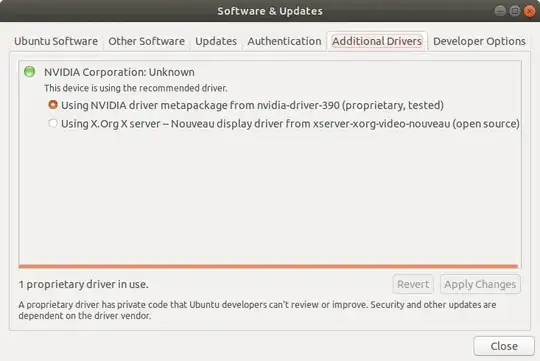

The similar stuck issue occurs when I try to restart or shutdown the system after a new installation of ubuntu 18.04.2 on my laptop.
I solved the problem by switch from Nouveau driver to Nvidia driver, using Software & Updates App, as following screenshot. The problem disappers after using Nvidia driver, so I assume there are some potential bugs in Nouveau driver.
Just for references, here is my video card info:
$ ubuntu-drivers devices
== /sys/devices/pci0000:00/0000:00:1c.0/0000:01:00.0 ==
modalias : pci:v000010DEd00001D12sv00001D72sd00001604bc03sc02i00
vendor   : NVIDIA Corporation
driver   : nvidia-driver-390 - distro non-free recommended
driver   : xserver-xorg-video-nouveau - distro free builtin
$ sudo lshw -c video
# OR
$ sudo lshw -c display
  *-display
       description: VGA compatible controller
       product: HD Graphics 620
       vendor: Intel Corporation
       physical id: 2
       bus info: pci@0000:00:02.0
       version: 02
       width: 64 bits
       clock: 33MHz
       capabilities: pciexpress msi pm vga_controller bus_master cap_list rom
       configuration: driver=i915 latency=0
       resources: irq:128 memory:b2000000-b2ffffff memory:c0000000-cfffffff ioport:4000(size=64) memory:c0000-dffff
  *-display
       description: 3D controller
       product: GP108M [GeForce MX150]
       vendor: NVIDIA Corporation
       physical id: 0
       bus info: pci@0000:01:00.0
       version: a1
       width: 64 bits
       clock: 33MHz
       capabilities: pm msi pciexpress bus_master cap_list
       configuration: driver=nvidia latency=0
       resources: irq:133 memory:b3000000-b3ffffff memory:a0000000-afffffff memory:b0000000-b1ffffff ioport:3000(size=128)
