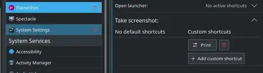

Working in Kubuntu 20.10 :
Go to System Settings
SystemSettings
Shortcuts > Global shortcuts
Settings_shotcut
click Add Application button (you can type "flameshot" on the search box)
addAplication
click OK
After adding the application, you should see a tab with Take screenshot description.
link PrtScr key to shortcut
Click on it, and press the PrtSc key on your keyboard to set the shortcut.
Enjoy :)
