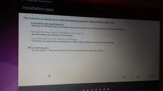

However, to control the whole process and understand exactly what you are doing - the second option ("Something else"):

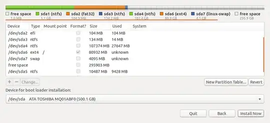

You'll see partitions, something like this:
Select only the root / partition (/dev/sda6 in this example - yours will be different).
