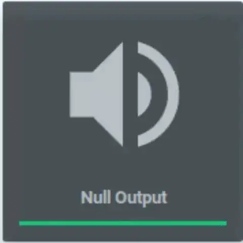

It's worth noting that on Ubuntu 17.10 and later with GNOME Shell, there is already (albeit somewhat convoluted) kind of support for this.
Press Shift+XF86AudioRaiseVolume or Shift+XF86AudioLowerVolume (usually the dedicated volume up / down keys on the keyboard) to change the volume with a smaller step size.

Kubuntu 21.04
It has been made really easy, but if you don't know about this solution it is hard to find...
Just right click on the volume icon in the system tray, select Configure Audio Volume... and set your desired Volume step on the General tab.
