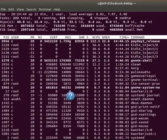

The output of top shows:
Output of top

  • Also, check and see what your memory usage is with 'top' or 'htop' during game play. Since you are using the Intel Graphics you would be using system memory, since there is no dedicated memory for the GPU. Depending on your configuration, that memory can be dynamically allocated. 'grep -i memory /var/log/Xorg.0.log' might show what it's set at. – G Trawo Jul 09 '18 at 01:22
  • My framerates reset right after starting a new game. I updated my post to include the results in 'top' – john bob Jul 10 '18 at 01:17

  • I note that your load is 8.8 for the 1M 7.07 for the 5m and 4.4 for 15m. This indicates that your CPU is way overworked. Have a look at this for load averages: https://www.howtogeek.com/194642/understanding-the-load-average-on-linux-and-other-unix-like-systems/ .... basically you have some process eating cpu. Can you provide top output when the computer is sitting completely idle? – stratus Dec 09 '19 at 14:41
