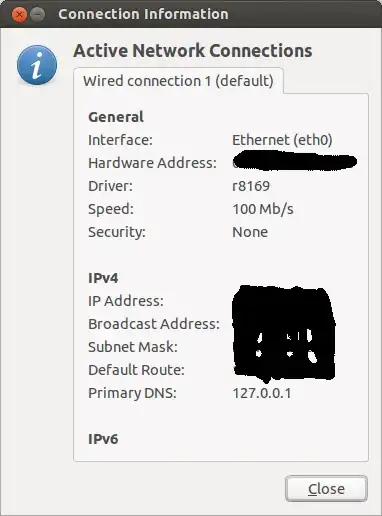

I installed dnscrypt 1.1 on Ubuntu 12.10.
I edited /etc/NetworkManager/NetworkManager.conf to comment out
dns=dnsmasq
Then add /etc/init/dnscrypt.conf and include in it the following:
 description "dnscrypt startup script"
 start on (local-filesystems and started dbus and stopped udevtrigger)
 stop on runlevel [016]
 script
         exec /usr/sbin/dnscrypt-proxy -a 127.0.0.1 -d
 end script
Next I changed my network settings to to use 127.0.0.1 for DNS:
Then I rebooted and made sure dnscrypt was running and that dnsmasq was not:
 ps aux | grep dns
 root      6581  0.0  0.0  16116   720 ?        Ss   04:47   0:00 /usr/sbin/dnscrypt-proxy -a 127.0.0.1 -d
Then I opened wireshark to verify that DNS was encrypted:
It appears it isn't.
Visiting http://www.opendns.com/welcome/ verifies I am using opendns.

OK, I've got it!
Run dnscrypt-proxy --deamonize (it should already be running)
  1. Go to the Network icon at the top and go down to Network Settings.
  2. Go to your current connection and click Configure...
  3. Go to IPv4 Settings tab.
  4. Under DNS Servers and Search Domains fields enter: 127.0.0.1
  5. Head to http://opendns.com/welcome
If you get redirected to http://opendns.com/welcome/oops then it's not setup properly.
Sorry about that. I didn't want to go to the pain to set it all up, but it was remarkably easy! Well, hope you learned something. I sure did!
