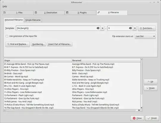

Krename is a KDE GUI for renaming files, generally found in most package managers.
This answer applies to removing leading numbers that may be found in music files such as mp3s. But Krename does mass rename as well.
  1. Load selected files or folder. Krename loads all files in the selected folder, just click on Open without having to individually select all files.
  2. Go to the Destination tab to overwrite or copy files to another folder.
  3. Go to the Filename tab, then to the Advanced Filename tab.
     "Advanced Filename" image showing the default settings.
  4. Start by removing the token $ in the Template window. A change takes place in the Renamed window below. No filenames appear, only the file extensions.
    3. Image shows that the filenames have been removed, leaving the file extensions.
  5. Click on Insert Part of Filename... and select the parts of the filename you want to keep. This operation will include all the files and the changes will be obvious in the Renamed window below.
    4. "Insert Part of Filename..." image showing how to select the filename by highlighting the preferred sections.
  6. Click OK. The files are renamed without the leading numbers.
    5. Final results showing.
  7. Finally, click Finished at the bottom right corner.
