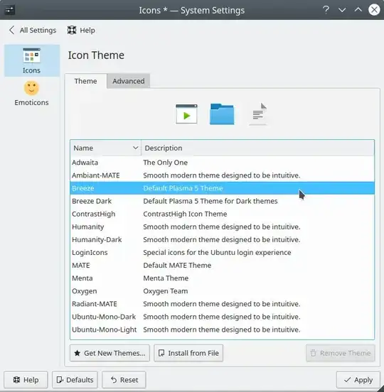

By default, my Apper looks like this:
Apper default
If I look in System Settings > Icons, I have:
Default Icon theme Breeze
But if I change the icon theme to Adwaita, I see some blank spaces:
Adwaita
I suggest you stay with Breeze. If, for some reason, it's missing from your system, sudo apt install breeze-icon-theme should make it available.
