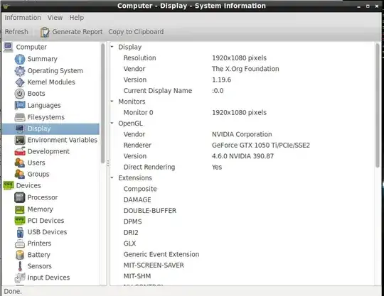

The attached screenshot shows that the NVIDIA 390.87 driver is running my GeForce GTX 1050 Ti card.
I installed this driver from the graphics-drivers ppa thusly:
sudo add-apt-repository ppa:graphics-drivers/ppa
sudo apt update
sudo apt install nvidia-384 nvidia-settings
Note: this is what I did, and 384 is supposedly a transitional package; you may be able to install nvidia-390 directly.

  • Hello Organic Marble!Thanks for your anwser! However I didn't get a driver yet by these commands.Maybe my kernel don't accept the driver cause my old machine that that is a Gigabyte VM900M.Do you know if someone have installed NVIDIA proprietary driver on an old motherboard like mine?My Ubuntu says to me that I don't have any additional driver available. – J-Mello Sep 28 '18 at 11:36
  • if you type 'apt policy nvidia-settings' in a terminal and [edit] your question to include the result, I may have other suggestions. – Organic Marble Sep 28 '18 at 12:18
  • @J-Mello The problem is not installing the driver. The driver exists and it works. But newer cards can't possibly work in a 2006 computer. –  Nov 11 '18 at 13:52
  • @GabrielaGarcia I agree and I know that my old computer will not run a graphics card like these newer as good as it would be cause the lower power of a 2 core cpu with only 1,2ghz!I'm looking for a 2018/2019 computer that I'll build buying each hardware component like i9 9900k,Gigabyte Z390, 32gb ram...with an amazing Cougar case.Then,my screen will not freeze anymore and certainly I will able to enjoy each feature of Ubuntu and grow up in Ubuntu and Linux community! :) – J-Mello Nov 27 '18 at 10:12
