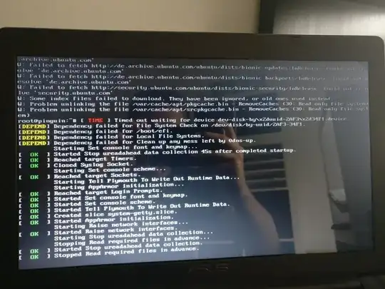

When ubuntu is started, the grub menu pops up. When I select "Ubuntu", a black screen showing "/dev/sda2: Recovering journal" and "/dev/sda2: clean .../... files, .../... blocks", afterwards the ubuntu logo pops up along with the white dots beneath. From than on, nothing happens, it is stuck.
What I tried/figured out (besides googling alot): So within the grub menu I selected the recovery mode and tested some things.
E.g. I ran "fcsk": This showed up and then the laptop was stuck (pressing enter did not help), also note the first line, that "/etc/default/rcS" was not found: fcsk
When I enter into the root console, after some time this shows up: failed boot for /boot/efi
Here is the output of blkid and content of /etc/fstab: fstab and blkid
What I also tried was running "dpkg". This this showed up and it was stuck as well: dpkg
I have no idea what to try or find out anymore sadly. Any help would be appreciated!

    @Corrumpo see update #1 in my answer. Report back. – heynnema Oct 24 '18 at 13:09
  • I tried that. In root access I entered "exit" afterwards and then pressed on "resume" afterwards. A warning about graphics appears (something like having to fully restart for some components to work) and afterwards I get into a console again showing "You are in emergency mode. [...] Press Enter for maintenance...". After I pressed enter, again, the computer is stuck. :( – Corrumpo Oct 25 '18 at 14:36
  • Afterwards I started in recovery mode again and entered root access, did the mount command, checked whether the changes were saved (they were saved) and entered "systemctl reboot" to make a regular shutdown, but still not booting :( Was just thinking that a regular shutdown could help because otherwise I always needed to press and hold the power button. – Corrumpo Oct 25 '18 at 14:37
  • The issue is likely related to that error message in my second image, right? – Corrumpo Oct 25 '18 at 14:38
  • @Corrumpo yes, second and third images. – heynnema Oct 25 '18 at 14:40
