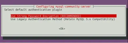

img_1
You can confirm whether you want to use the new password encryption feature... It is "recommended" to.
img_2
