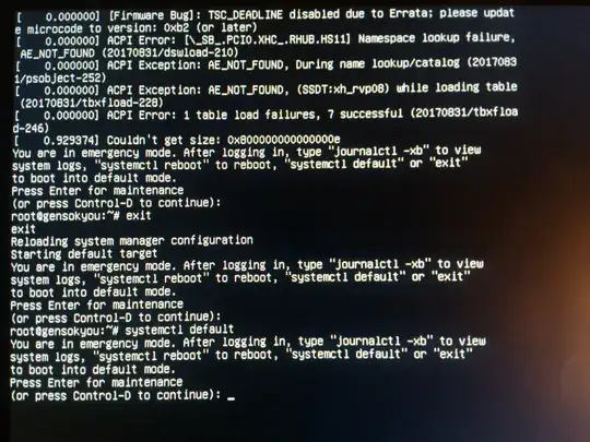

I woke up today, pressed power button and got this screen. enter image description here I did some research and uninstalled nvidia drivers, which caused pkcs errors to go away. More research, and enabling secure boot caused uefi thing to go away. So it looks like this now. enter image description here I have no clue what's going on, I just migrated to Linux from Windows a week ago and I am upset it bricked itself.
I can type startx and go to desktop as root but internet does not work and I don't really know what to do. (startx would not boot to desktop before I removed nvidia drivers which was version 390 by the way). I am using kubuntu 18.04.1.
Some help would be nice.
(specs: Asus z170i pro gaming, i5-6400, evga gtx 1060)
Kyuunex
answering my own question here for visibility, the ACPI errors and PKCS in the log actually have nothing to with the real problem i had. gonna quote my own comment from the other answer.
"Alright, so I found the issue. Yesterday I formatted one of my drives to ext4 from ntfs because the specific application required me to use ext4 partition. However, I didn't made necessary changes to /etc/fstab to let the system know it's no longer NTFS. To fix this, I had to remove extra drive mount points from that file, save, reboot."
basically, it just got stuck on this step of the boot process because it was unable to mount the drive.

    Thanks for coming back and answering, I've had similar fstab problems and they can be quite mysterious - no helpful error messages. Good to reinforce the ever useful question "what did I change recently?" – Organic Marble Dec 26 '20 at 14:09
    I agree with @OrganicMarble. I might add most users get `ACPI` messages and they are sometimes mistaken as fatal error messages when they are not the root cause of the problem. – WinEunuuchs2Unix Dec 26 '20 at 16:57

  • i remember removing `intel-microcode` package because it caused a problem with something else but that was a week ago and it worked fine for a week. maybe an update that depended on it got installed and it bricked it self. – Kyuunex Dec 06 '18 at 18:09
  • Sounds right. Thanks for that https://askubuntu.com/users/464666/kyuunex –  Dec 06 '18 at 18:09
  • installing `iucode-tool` and `intel-microcode` made that firmware bug message disappear but other messages are still there. – Kyuunex Dec 06 '18 at 18:24
  • Some of those can be ignored, does the system boot now? –  Dec 06 '18 at 18:34
  • nope, it's stuck on this screen unless i press enter and then type startx, that takes me to desktop as root without internet access – Kyuunex Dec 06 '18 at 18:36
  • I see, this looks akin to your issue: https://askubuntu.com/questions/954706/acpi-errors-ubuntu-16-04-17-04-can-not-be-installed Looks like you can get grub to hang in there longer and allow more ACPI errors and still boot. GRUB_CMDLINE_LINUX_DEFAULT="quiet splash acpi_rev_override=5" –  Dec 06 '18 at 18:42
  • Alright, so I found the issue. Yesterday I formatted one of my drives to ext4 from ntfs because the specific application required me to use ext4 partition. However, I didn't made necessary changes to /etc/fstab to let the system know it's no longer NTFS. To fix this, I had to remove extra drive mount points from that file, save, reboot. – Kyuunex Dec 06 '18 at 19:10
