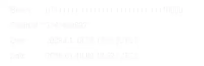

I don't know why it's happening only to me. Whenever copying bigger or sometimes smaller < 1GB files from PC to pendrive literally gets stuck at the end.
now this stucks
