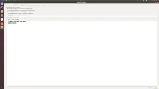

I am having Hash Sum Mismatches all over the place for the past two weeks. At first I thought nothing of it, but now that they have persisted for so long, there must be an underlying problem.
I see them on my regular machine, but also when I start up a Docker container. I did not expect to see them also in the Docker container. I would have thought I simply had some configuration error on my main machine. In an attempt to solve this, I have tried various permutations of
sudo rm -rf /var/lib/apt/lists/*
sudo apt update
sudo apt clean
as suggested by multiple threads:
I also made sure that I am getting updates from the Main Serverenter image description here:
Any other ideas?
