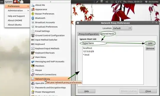

Assuming you're using the default Ubuntu Gnome desktop: You need to add your local host addresses to the ignore list in the gnome proxy settings:
alt text
Martin Owens -doctormo-
  • 19,860
  • 63
  • 103
    I know about this, what I'm wondering is there anyway to add all addresses that do not have a domain... such as http://intranet or http://sharepoint to this site implicitly. It would really suck to have to add thousands of ignore entries. – spoon16 Nov 04 '10 at 04:38
    That wasn't your question though. You asked how to ignore localhost addresses, this is how you do that. You should use the *.local address for all your localhost services anyway, that will make it easier to specify in this ignore list. But I don't know why you would have thousands of localhost services, could you explain? – Martin Owens -doctormo- Nov 04 '10 at 04:46
  • Using either .local when using mDNS/Avahi or some other LAN domain when using DNS (including when using something like Active Directory) is a good idea indeed. – JanC Nov 04 '10 at 11:44
  • Owens, my question was how to ignore ALL local host addresses. I reread it, I think the wording is clear :) I work at a very large organization, internal resources are not referred to locally with any sort of domain identifer in hrefs and there are literally thousands of domain local resources on the network. – spoon16 Nov 04 '10 at 17:29
  • Then you mean 'local network' not 'local host'. Although I maintain that a properly configured network would have only a handful of common domains. Your network seems misconfigured, but if you can't do anything about that now, then you could make a script and download the local dns repository parse it and put them all in ignores which are all stored in gconf. I don't think there is any existing way to do that, although perhaps a feature bug would be a good place to start from. – Martin Owens -doctormo- Nov 05 '10 at 08:21
