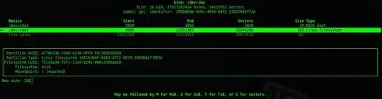

2. Faster Method Tested in Ubuntu Server 18.04.3 LTS
This method is a little faster than the first. This is due to a new option in the cfdisk menu called "Resize" that saves some steps.
After extending the volume in VMware ESXi (shutdown vm, backup/export vm, remove all snapshots, then increased number in disk size, take snapshot of vm again before following the next steps so you can revert mistake/error).
The following example is extending volume on root partition on a system that is already using LVM.
  1. ssh into the system, switch to root and run cfdisk.
  2. Choose the partition to extend and select "Resize". enter image description here
  3. Set the "New size". enter image description here
  4. After pressing enter, you'll see screen with the following note "Partition [someNumber] resized": enter image description here
  5. Next you'll need to "Write" (save) your changes: enter image description here enter image description here enter image description here
  6. Quit cfdisk. When you exit you may see message "syncing disks". enter image description here enter image description here
  7. I rebooted my system at this point but it may not be necessary. Now you can pickup from step 19 from the first method (repeated below).

With cfdisk and resize2fs I was able to extend my / partition on proxmox VM. Thanks to jtlindsey for the example.
I had the next picture before extending:
Model: QEMU QEMU HARDDISK (scsi)
Disk /dev/sda: 107GB
Sector size (logical/physical): 512B/512B
Partition Table: linux
Disk Flags:
Number  Start   End     Size    Type      File system     Flags
 1      1049kB  40,0GB  40,0GB  primary   ext4            boot
 2      40,0GB  53,7GB  13,7GB  extended
 5      40,0GB  53,7GB  13,7GB  logical   linux-swap(v1)
With cfdisk I've removed swap partition, then resized my / partition with Resize option to 80Gb and recreated the swap partition. Then I've written changes with Write option:
    Device               Boot                         Start                 End             Sectors          Size          Id Type
>>  /dev/sda1            *                             2048           167774207           167772160           80G          83 Linux
    /dev/sda2                                     167774208           209715199            41940992           20G          82 Linux swap / Solaris
│Partition type: Linux swap / Solaris (82)                                                                                                              │
                              [Bootable]  [ Delete ]  [ Resize ]  [  Quit  ]  [  Type  ]  [  Help  ]  [  Write ]  [  Dump  ]
After this I've rebooted and used the following command to extend my file system to the current partition's size:
$ sudo resize2fs /dev/sda1
Make sure you've created backup of important data before any disk changing action. So, jtlindsey's method could be used even for none-LVM partitions.
Also do not forget to get swap back by:
$ sudo mkswap /dev/sda2
And change UUID of swap partition in /etc/fstab to what sudo blkid shows for it.
