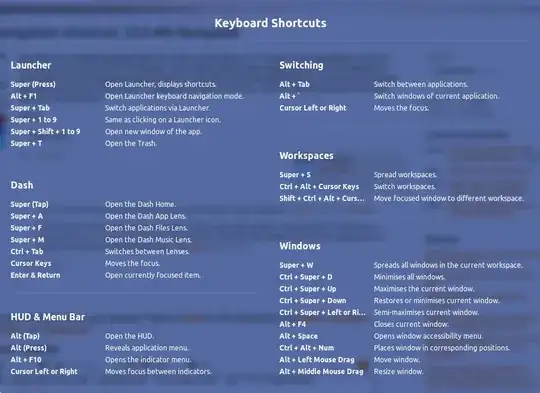

The shortcuts have been replaced with Ctrl+Super+Left and Ctrl+Super+Right. At the moment, Compiz (Unity's backend) does not support multiple shortcut keys for one action. This may change in the future.
Hold down Super to see them all:

    Thank you - really appreciate the informative response and have checked the Ctrl-Super-Left and Right shortcuts work for me. This will be fine for the time being although looking at the forums I can see other comments on the same topic and it would be good if a future release did address this – davposs May 06 '12 at 06:50
    How would we go about changing the Ctrl + Super + {Left/Right} to make use of the keypad 4 and keypad-6 keys? This is highly annoying, considering that the keypad owns the majority of the window movement commands, but yet the left and right movements are removed and placed on the arrow keys, requiring the user to lift their right hand off the keypad to go to the arrows. – Jack May 08 '12 at 04:11
  • see @blackhawkover's answer: change key bindings in ccsm > grid – amc May 08 '12 at 05:56
    My question already states what the new hotkeys are; I am asking how to return them to their former numpad mappings. – holocronweaver Jul 31 '12 at 13:33
