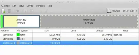

I have tried with GParted: it creates a partition with 4GB with no problem, however the whole .img of the SD card continues to be 16 GB with 12 GB of unallocated space.
GParted table

Resize partition using GParted:
Let's load the new device using GParted:
sudo gparted /dev/loop0
When the GParted application opens, it should appear a window similar to the following:
screenshot
Now notice a few things:
  • There is one partition.
  • The partition allocates the entire disk/device/image.
  • The partition is filled partly.
We want to resize this partition so that is fits its content, but not more than that.
Select the partition and click Resize/Move. A window similar to the following will pop up:
screenshot of dialog
Drag the right bar to the left as much as possible.
Note that sometimes GParted will need a few MB extra to place some filesystem-related data. You can press the up-arrow at the New size-box a few times to do so. For example, I pressed it 10 times (=10MiB) for FAT32 to work. For NTFS you might not need to at all.
Finally press Resize/Move. You will return to the GParted window. This time it will look similar to the following:
unallocated space on right
Notice that there is a part of the disk unallocated. This part of the disk will not be used by the partition, so we can shave this part off of the image later. GParted is a tool for disks, so it doesn't shrink images, only partitions, we have to do the shrinking of the image ourselves.
Press Apply in GParted. It will now move files and finally shrink the partition, so it can take a minute or two, but most of the time it finishes quickly. Afterwards close GParted.

You can make use of the options bs and count in the dd-command to limit the size of the output file.
Example:
dd if=sdx of=SD.img bs=1G count=4
would result in an outputfile with a size of 4 GiB.
Take a deep look into man dd.
You'd need to know how many bytes you have to copy so that all partitions are fully covered, so take a look with sudo fdisk -l /dev/sdx which sector is the last one you need.
The partitions need to be at the start of the disk (like in the picture you provided).
Disks with msdos-partition-table can be cloned easily this way, but if the disk uses GPT and is to be cloned to a disk with different size, the protective MBR needs to be adapted afterwords and the GPT-backup which resides at the very end of the disk needs to be recreated, this can be done with gdisk.
From your fdisk-output you can see that the last sector of the last partition is sector 8595455, that means you have to copy at least 8595455+1 sectors (first sector is 0). With a sector-size of 512 bytes this is equal to 4,400,873,472 bytes. bs multiplied with count have to be greater or equal than this.
Maybe this is still too big for a 4GB USB-stick, you can still reduce the size of sdc2, there's plenty of unused space in it.
For the current example you provided,
 dd if=/dev/sdc of=SD.img bs=10M count=420
will cover the partition-table, sdc1 and sdc2. Calculate:
10*1024*1024*420 = 4,404,019,200 > 4,400,873,472
mook765
  • 14,911
  • 67
  • testing the solution. One question: what do you mean with "You'd need to know how many bytes you have to copy so that all partitions are fully covered, so take a look with `sudo fdisk -l /dev/sdx` which sector is the last one you need. The partitions need to be at the start of the disk (like in the picture you provided)". Also I am updating the question with the output of the command you were speaking about. – Leos313 Sep 16 '19 at 10:14
  • You don't want to clone empty space, that's why the partitions should be at the start of the disk. And you don't want to clone a part of a partition (file-system), that's why you need to know on which sector the last partition on the disk ends. – mook765 Sep 16 '19 at 10:19
  • this was the solution I have founded, detailed with commands and images and it works. It is a similar answer but uses, also `truncate` and a loopback device. It works properly. https://softwarebakery.com//shrinking-images-on-linux Once also this answer is update I will vote up, it was the key to find the solution – Leos313 Sep 16 '19 at 10:35
