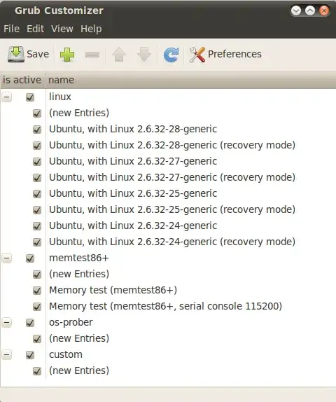

    The way I do it is I have the timeout set to 0 (Set using Grub Customizer). I am able to have no GRUB2 menu appear unless I hold shift right after my bios, which then displays the menu. sudo add-apt-repository ppa:danielrichter2007/grub-customizer sudo apt-get update sudo apt-get install grub-customizer – Ryan McClure Mar 31 '12 at 05:18

install grub optimizer
sudo apt-get update
Grub Customizer will now show up in the Applications > System Tools menu.
Or you can open it from the command line.
gksudo grub-customizer
image inside for grub options
pankaj sharma
  • 795
