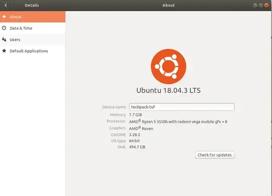

This is the About info regarding the machine:
about the machine

  • @singrium After installing the drivers, I am sure Ubuntu was not using Nvidia. _About_ section as well as the output of `glxinfo|egrep "OpenGL vendor|OpenGL renderer"` showed AMD only. – mgs Sep 28 '19 at 20:41
