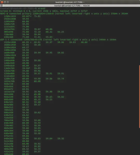

Latest xrandr output: xrandr

Finally, I made it work on dual screen. I did many steps and is one of the solutions that makes you wonder "It works, how??". My last steps was:
1 - I enabled/selected gdm3 instead of lightdm as manager:
sudo gdm3
sudo dpkg-reconfigure gdm3
2 - Log into recovery mode following steps here.
3 - Completely delete the file rm -rf /etc/X11/xorg.conf
4 - Run X -configure, but NOT replace the file that was created /root/xorg.conf.new into /etc/X11/xorg.conf.
5 - Reboot into normal mode and I was expecting something messed up, but suddenly dual monitor was active and working fine.
Currently, it works without any xorg.conf file.
enter image description here enter image description here enter image description here enter image description here
I am little bit scared to touch it right now, although that I think that I should try to re-create the xorg.conf file, maybe through nvidia?! I hope that this could be useful to others with similar issue.
Also, if I enable secure boot on bios goes back to zero and dual monitor is not working, although that ubuntu are running properly. Maybe, need to signed drivers into kernel or something, I am not sure.
If anyone has any idea about what actually happened, I will be happy to hear.
