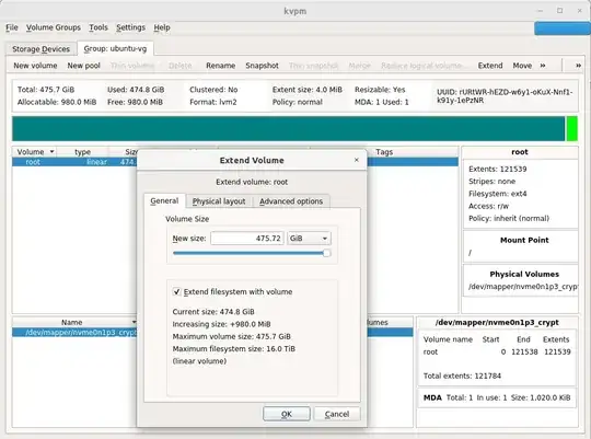

GParted doesn't handle LVM (Logical Volume Management) volumes. You need to install an LVM manager for that, such as kvpm. Shown below is a screenshot of kvpm from my system where you can see the swap volume within the nvme0n1p3 partition.
kpvm screenshot with swap volume
After deleting the swap volume, kvpm crashed, but then I was able to resize the root volume to include the extra ~1GB that the swap volume had occupied (right click, Extend logical volume):
kpvm resize screenshot
I still don't know what the ext4 partition from my question (nvme0n1p2) is used for.
Also, once I deleted the swap volume, I was unable to create another one due to lack of space. The option to Reduce the size of the root volume was grayed out.
I confess I don't fully understand LVM and kvpm, so I'd stick with a swapfile, which is clear and simple to manage (delete and recreate with different size).
