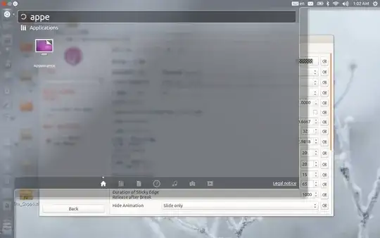

To stop the dash and launcher to use the same color of the wallpaper. You can use CompizConfig Settings Manager to override this behavior.
  • Open CompizConfig Settings Manager
  • Search for Ubuntu Unity Plugin and open it.
  • Click on Experimental tab
  • Now click Background Color option and enter your desired color for dash & launcher.
Normal Behavior
After applying the changes
