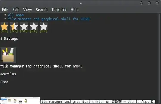

I did not use my computer for a month. On starting Dropbox after opening it, it shows the following Could not start dropbox daemon On checking the Dropbox site for system requirements System requirements enter image description here enter image description here enter image description here So I went about checking all these requirements, GTK went about checking
Glibc also (ldd in ubuntu) glibc
Libappindicator 12.10 or higher libappindicator
Nautilus 3.10.1 or higher nautilius
libatomic version check libatomic version check
