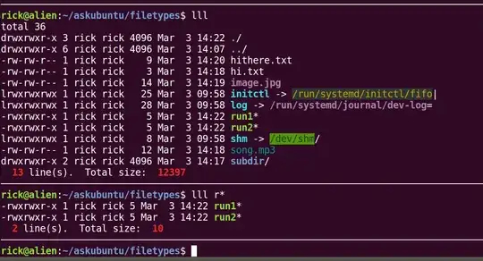

I'm conditioned to the ll command which is aliased to ls -alF. It is just missing a file count and size of files at the bottom. I played with du and tree but could not get the totals I needed. So I created lll to do that for me.
In your ~/.bashrc place the following:
lll () {
    ls -alF "$@"
    arr=($(ls -alF "$@" | awk '{TOTAL+=$5} END {print NR, TOTAL}'))
    printf " \33[1;31m ${arr[0]}\33[m line(s).  "
    printf "Total size: \33[1;31m ${arr[1]}\33[m\n"
#    printf "Total size: \33[1;31m $(BytesToHuman <<< ${arr[1]})\33[m\n"
Save the file and resource it using . ~/.bashrc (or you can restart your terminal).
Sample output
The nice thing about ll output is it's colors. This is maintained with lll but lost when using find or du:

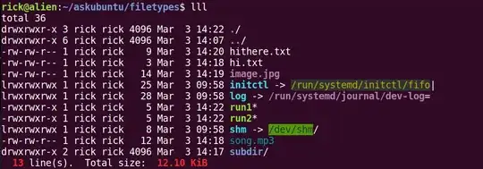

TL;DR
A bonus function you can add to ~/.bashrc is called BytesToHuman(). This does what most console users would expect converting large numbers to MiB, GiB, etc:
function BytesToHuman() {
    # https://unix.stackexchange.com/questions/44040/a-standard-tool-to-convert-a-byte-count-into-human-kib-mib-etc-like-du-ls1/259254#259254
    read StdIn
    b=${StdIn:-0}; d=''; s=0; S=(Bytes {K,M,G,T,E,P,Y,Z}iB)
    while ((b > 1024)); do
        d="$(printf ".%02d" $((b % 1024 * 100 / 1024)))"
        b=$((b / 1024))
        let s++
    done
    echo "$b$d ${S[$s]}"
} # BytesToHuman ()
Next flip the comment between two lines in lll () function to look like this:
#    printf "Total size: \33[1;31m ${arr[1]}\33[m\n"
Now your output looks like this:
As always don't forget to re-source with . ~/.bashrc whenever making changes. (Or restart the terminal of course)
