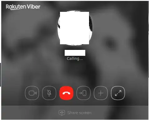

I am unable to make/answer viber calls on Ubuntu 20.04.
I downloaded viber.deb from https://www.viber.com/en/download/ and tried to install it using gdebi. On installation it showed that the libssl1.0.0 is missing, so I downloaded and installed libssl1.0.0_1.0.2n-1ubuntu6.2_amd64.deb, libssl1.0-dev_1.0.2n-1ubuntu6.2_amd64.deb and openssl1.0_1.0.2n-1ubuntu6.2_amd64.deb. After that I succesfully installed and activated viber on my laptop so I tried to make a call but it never gets to ringing, just stuck on calling.
Stuck on calling
Also, when someone calls me, I cannot answer the call on laptop. It rings normally, but does not react to my clicking on the answer button.
The same dependencies were missing on Ubuntu 19.04, but I was able to make a call after installing the libssl1.0 packages.
I tried editing dependencies in viber/DEBIAN/control and changed libssl1.0.0 to libssl1.1 (following instructions from Ubuntu 18.04 Unable to install Viber ) with the same end result- still not able to make a call.
Downloaded viber.rpm and repackaged it using alien to deb and installed it but the problem persists
