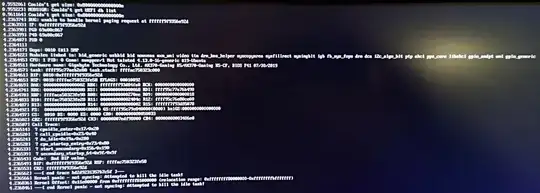

I also tried Boot Repair liveUSB (tested working on another machine):
Unable to handle null pointer dereference at #
Oops: 0002 [#1] SMP
Tainted 4.13.0-16-generic ubuntu (& lots more output)
Kernel panic, not syncing, fatal exception in interrupt, shutting down cpus with MMI

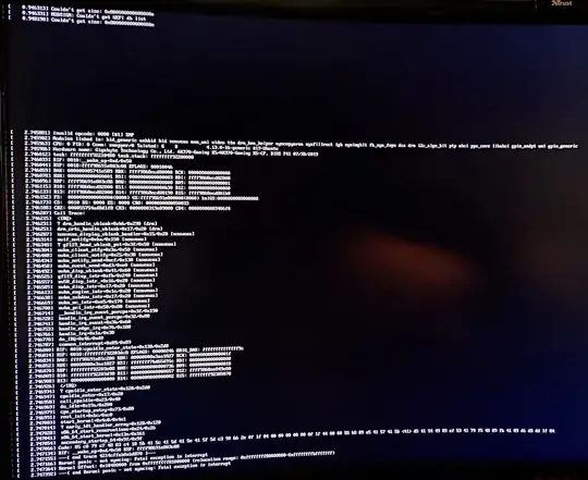

Trying BootRepair with ide=noidma:
screenshot1
Trying BootRepair again with default settings, says BootRepairDisk for a second in blue then:
screenshot2
