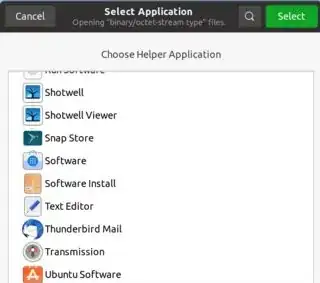

The Problem
Ubuntu 20.04 has two 'Software Install' applications, one is gnome-software and the other is snap-store, installed by Canonical via snap. This snap app software centre has the problem installing local files from the /tmp directory. Can be easily verified by running these commands:
gnome-software --local-filename '/tmp/mozilla_user0/app_amd64.deb'
snap-store --local-filename '/tmp/mozilla_user0/app_amd64.deb'
The snap-store command will error with Failed to install file: not supported
Workarounds
You can install gdebi or similar software as suggested in other answers but there is a workaround to modify the file association to use the other Software Install which is associated with gnome-software:
Firefox
When choosing application to open change for the suggested or default Software Install to the other further down the list. This second one is the gnome-software association.
You can verify that it is gnome-software in Preferences->Applications:
Nautilus
The same can be done within Nautilus by right-clicking and opening Properties for a /tmp/.deb file and switching the Open with from current default Software Install to the other suggestion.
[enter image description here]
