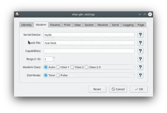

Settings of efax-gtk look like this
/dev looks like this

    I have lots of ttyS entries, from ttyS0 to ttyS31. Which one to choose? I pasted a screenshot into my post. – shmu Jun 07 '20 at 03:11

  • Then I ran "dmesg | grep tty [ 0.114231] printk: console [tty0] enabled [ 0.482168] 00:02: ttyS0 at I/O 0x3f8 (irq = 4, base_baud = 115200) is a 16550A [ 0.557833] tty tty24: hash matches" so I guessed that in efax, I should set the modem serial device to tty24. But the fax failed immediately, saying I don't have permission for that port. – shmu Jun 16 '20 at 15:36

It's been some years since I did this process myself (also on Kubuntu, fortuitously), but a quick glance at your screenshot shows an absence of either dev/modem or dev/ttySHSF0 is suggesting to me that you either haven't installed the kernel module for your device, or if so then it is failing to load. I'm not sure what your thought process was regarding the sl-modem-daemon (for SmartLink chipsets, not Conexant), but I would start by uninstalling it.
