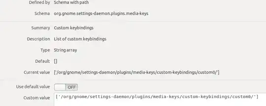

I have created a custom shortcut and bound the shutter -s to it:
Then I tried to find out where this command is stored and checked settings by dconf-editor. But there are no information about the shutter -s bound command and Shift + Print combination:
Thus, the questions:
  1. Where full information about key bindings is stored? Does a way exist to say: this key combination is using this command? For example, I want to see the default screenshot command which is executed on the Print press.
