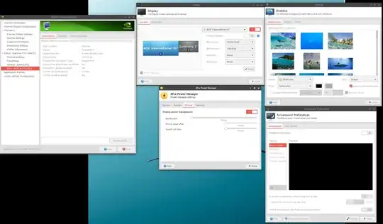

I'm running out of space on my ubuntu partiton so i want to increase it by taking some space out of the windows side. My gparted looks like this with the largest rectangle being the windows side:
enter image description here Could someone offer a step by step solution to this. I know almost nothing concerning this topic. I know there are other similar posts but the gparted window is almost always just slightly different from mine so I was afraid of following it. I don't want to accidentally break something.
