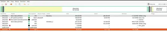

Here is the gparted view from my Ubuntu Linux 20.4 LTS enter image description here
There is somehow hidden Ubuntu 20.4 LTS being installed some where else also which is making my grub to boot into Ubuntu 20.4 LTS Linux.
Update 2 After some more searching and digging, found that another copy of Ubuntu Linxu 20.4.1 LTS is installed on /dev/sda7 enter image description here
and also confirmed by df command

Update 3 Even after deleting /dev/sda7 partition from Windows and then deleting /EFI/ubuntu - i was not able to make Windows 10 boot. Thus used the live USB drive to copy the important data from Windows C: into Windows D: Later used the Windows recovery drive to reinstall the Windows on C: drive. I could have installed it on other drive but my C: is SSD and i prefer installing OS and apps on faster media.
