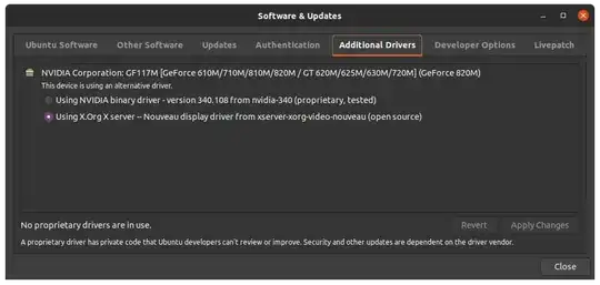

I installed Ubuntu 20.04 LTS yesterday and faced this exact same problem. This and whenever I close and re-open my laptop lid, the wallpaper gets corrupted, but that's a whole other question. After some messing around I figured out how to solve this issue. All you have to do is change the graphics driver from NVIDIA Binary Driver to X.Org X Server in the Additional Drivers section under Software & Updates (Remember to click Apply Changes, this will take a while). After the changes have been applied, restart your PC. Doing this fixed the issue and the other bug I mentioned above.
Cheers!
The method above is a permanent fix. If you want to use the NVIDIA driver, I think you're gonna have to wait for the developers to release a patch.

    Switching from NVIDIA binary driver to the X.Org X Server driver then rebooting fixed the problem for me. – Brandon Miller Aug 24 '20 at 08:44
    @BrandonMiller glad I could help :) – Sujit Aug 24 '20 at 13:20
  • Not the solution if you use an Intel graphics card (and yes, it affects me to). Best workaround: a startup script as indicated in the answer by Lorenz Keel – vanadium Aug 24 '20 at 19:46
  • @vanadium, I see... thanks for letting me know – Sujit Aug 25 '20 at 06:53
  • Changing the graphics card driver is definitely not the solution, as it can have way more impact on the system than the bug itself. Besides, people who bought a (expensive) specific graphics card and installed the official driver did it for some reason and removing the whole device functionality due to some fonts bug in the desktop manager is not acceptable at all. – José L. Patiño Sep 14 '20 at 08:57
  • @JoséL.Patiño you don't have to change it to X.Org, those were the only two choices for me why I wrote this answer. Now there are more, just switch it to the latest NVIDIA driver and the problem should probably get fixed, otherwise just wait for Ubuntu 20.04.2, a fix to mutter has been pushed for that version, but will be released only in Feburary 2021. There is a way to get the fix on 20.04.1 itself, but that could lead to more bugs so I wouldn't recommend it until they officially release it. – Sujit Nov 28 '20 at 04:04

This is because your NVIDIA Driver go to software & updates, Tab Additional Drivers and change it to X.org this solve my problem and wait for a patch from Nvidia
