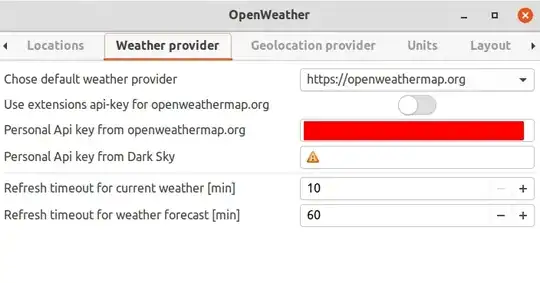

First, you need to enable Firefox to manage your local Gnome-Shell extensions.
Go to https://extensions.gnome.org/local/, and check if you need to install two pieces of software. Just follow the onscreen instructions.
Then go to https://extensions.gnome.org/extension/750/openweather/ to enable the OpenWeather extension. Once installed, go to https://openweathermap.org to obtain a free personal API key, and paste it in in the OpenWeather settings panel. See image below...
Update #1:
In newer versions of OpenWeather, instead of obtaining a free personal API key, you can just flip the Use extensions api-key for openweather.org to ON.
