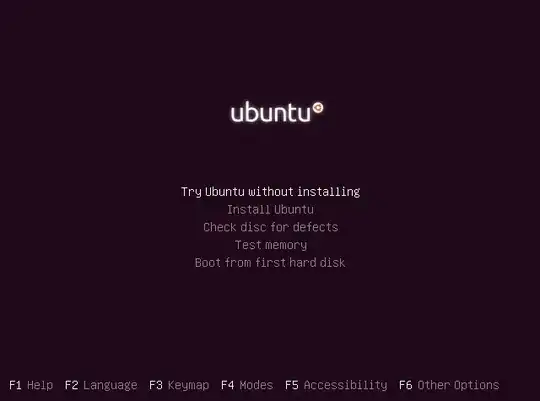

If you have not tried it yet, you could attempt booting using different options you can enable from the Ubuntu CD/USB Boot Options Page.
The Live CD/USB Boot Options page is usually not seen when a Live CD/USB is booted. To display it you have to trigger it by pressing any key when the small logo Ubuntu Live CD/USB 'small logo' appears at the bottom of the screen. The Live CD/USB should stop booting and display the Advanced Boot Options menu shown below.
Ubuntu Live CD/USB Advanced Boot Options menu
The main thing this page appears to provide is an easy way to allow you to boot with common kernel options applied. You press the F6 key and use the space bar to select/unselect the option(s) you want to apply and then resume the boot. 3 kernel options selected with F6
(By the way, have you already tried booting with the nomodeset kernel option? It seems to be a popular recommendation whenever video may be the problem.)
The F1 Help key displays a (nested) list of function keys showing the Live CD/USB version, boot methods, special boot parameters, and (dated?) hardware help information. I think it is mostly useful as a way to verify the release number and build date of the Live CD/USB you are booting. (It would be nice if it also mentioned whether it was 32-bit or 64-bit. Oh, well.)
Since I am not that familiar with the various options, I'll stop here and just suggest you read the Ubuntu online help to learn more about them. (I would only be parroting what it says there.)
