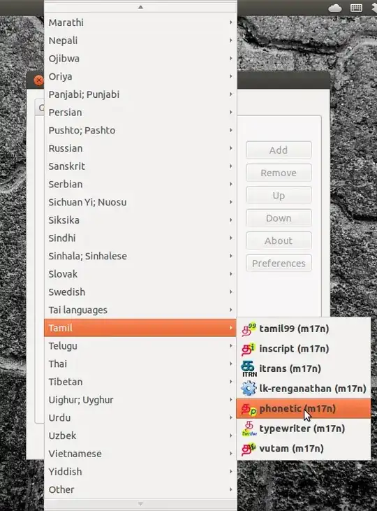

Yes. You can type Tamil phonetically in Ubuntu 12.04.
Install the following packages:
sudo apt-get install m17n-db m17n-contrib ibus-m17n
You might have to log out and back in to see the various layouts.
To enable phonetic typing for Tamil, search for Keyboard input methods in the dash and open it.
Go to Input method tab and click on Select an Input method. Scroll down to Tamil and you will have a couple of options to install. Choose Phonetic from the list and install it.

    Ctrl+Space to start using தமிழ் phonetic and also to revert to English. – parithimathi Jul 01 '12 at 17:38
  • Thanks for that. If either of the answer helped you, consider accepting the answer. Thanks again! – jokerdino Jul 02 '12 at 06:22
  • thanks for a detailed answer with screenshots. but by default we don't have all the keyboard layouts listed. looks like the other answer points to the post which points out the packages to install to get the relevant keyboards (including phonetic and tamil99) – rpattabi Jul 28 '12 at 13:59
  • @ragu.pattabi Let me know how I can improve my answer if you find out the relevant package. Thanks. – jokerdino Jul 28 '12 at 14:04
  • as per the article pointed out in the other answer, the packages are 'm17n-db m17n-contrib ibus-m17n' (of course, apt-get install). I needed to logout and log back in to see the layouts. – rpattabi Jul 28 '12 at 14:23

These are the steps for Ubuntu 14.04:
  • Install the ibus-m17n package:
    sudo apt-get install ibus-m17n
  • Log out and log in again.
  • Select the Tamil (phonetic (m17n)) (IBus) option in Text Entry.
